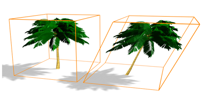

Skew Modifier
The Skew modifier lets you produce a uniform offset in an object's geometry. You can control the amount and direction of the skew on any of three axes. You can also limit the skew to a section of the geometry.

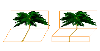

Skew modifier applied
Effect of moving modifier center with limits set

To skew an object:
  1. image Select an object, go to the image Modify panel, and choose Skew from modifier list.
  2. On the Parameters rollout, set the axis of the skew to X, Y, or Z. This is the axis of the Skew gizmo, not the axis of the selected object.
    You can change the axis at any time, but only one axis setting is carried with the modifier.
  3. Set the amount of the skew. The amount is an offset in current units parallel with the axis.
    The object skews to this amount beginning at the lower limit, by default the location of the modifier's center.
  4. Set the direction of the skew.
    The object swivels around the axis.
    You can reverse the amount and direction by changing a positive value to a negative value.
To limit the skew:
  1. Turn on Limits group > Limit Effect.
  2. Set values for the upper and lower limits. These are distances in current units above and below the modifier's center, which is at zero on the gizmo's Z axis. The upper limit can be zero or positive, the lower limit zero or negative. If the limits are equal, the result is the same as turning off Limit Effect.
    The skew offset is applied between these limits. The surrounding geometry, while unaffected by the skew itself, is moved to keep the object intact.
  3. At the sub-object level, you can select and move the modifier's center.
    The limit settings remain on either side of the center as you move it. This lets you relocate the skew area to another part of the object.
