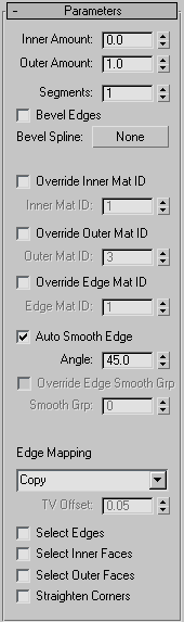

Interface
Inner/Outer Amount
Distance in 3ds Max generic units by which the inner surface is moved inward and the outer surface is moved outward from their original positions. Defaults=0.0 / 1.0.
The sum of the two Amount settings determines the thickness of the object's shell, as well as the default width of the edges. If you set both to 0, the resultant shell has no thickness, and resembles an object set to display as 2-sided.
Segments
The number of subdivisions across each edge. Default=1.
Change this setting if you need greater resolution on the edge for use by subsequent modeling or modifiers.
Note: When you use a Bevel Spline, the spline's properties override this setting.
Bevel Edges
When on, and you specify a Bevel Spline, 3ds Max uses the spline to define the edges' profile and resolution. Default=off.
After you define a Bevel Spline, use Bevel Edges to switch between a flat edge whose resolution is defined by the Segments setting and a custom profile defined by the Bevel Spline.
Bevel Spline
Click this button and then select an open spline to define the edge shape and resolution. Closed shapes such as Circle or Star will not work.
The original spline is instanced to the Bevel Spline, so changing the spline's shape and properties are reflected in the Bevel Spline. With non-corner vertices, you can change the edge resolution with the spline's Interpolation rollout settings.
A bevel spline as viewed from the top (inset) and the resulting bevel
Tip: For best results, create the spline in the Top viewport, and draw it from top to bottom. The top point on the spline is applied to the outside edge, and the bottom point to the inside edge. Displacements to the right will create outward protrusions on the edge profile, and displacements to the left create inward protrusions.
Override Inner Mat ID
Turn on to specify a material ID for all of the inner surface polygons using the Inner Mat ID parameter. Default=off.
If you don't specify a material ID, the surface uses the same material ID or IDs as the original faces.
Inner Mat ID
Specifies the material ID for inner faces. Available only when Override Inner MatID is on.
Override Outer Mat ID
Turn on to specify a material ID for all of the outer surface polygons using the Outer Mat ID parameter. Default=off.
Outer Mat ID
Specifies the material ID for outer faces. Available only when Override Outer MatID is on.
Override Edge Mat ID
Turn on to specify a material ID for all of the new edge polygons using the Edge Mat ID parameter. Default=off.
If you don't specify a material ID, the surface uses the same material ID or IDs as the original faces from which the edges are derived.
Edge Mat ID
Specifies the material ID for edge faces. Available only when Override Edge MatID is on.
Auto Smooth Edge
Applies automatic, angle-based smoothing across the edge faces using the Angle parameter. When off, no smoothing is applied. Default=on.
This doesn't apply smoothing across the junction between the edge faces and the outer/inner surface faces.
Angle
Specifies the maximum angle between edge faces that will be smoothed by Auto Smooth Edge. Available only when Auto Smooth Edge is on. Default=45.0.
Faces that meet at an angle greater than this value will not be smoothed.
Override Smooth Group
Lets you specify a smoothing group for the new edge polygons using the Smooth Grp setting. Available only when Auto Smooth Edge is off. Default=off.
Smooth Grp
Sets the smoothing group for the edge polygons. Available only when Override Smooth Group is on. Default=0.
When Smooth Grp is set to the default value of 0, no smoothing group is assigned to the edge polygons. To specify a smoothing group, change the value to a number between 1 and 32.
Note: When Auto Smooth Edge and Override Smooth Group are both off, 3ds Max assigns smoothing group 31 to the edge polygons.
Edge Mapping
Specifies the type of texture mapping that is applied to the new edges. Choose a mapping type from the drop-down list:
TV Offset
Determines the spacing of the texture vertices across the edges. Available only with the Edge Mapping choices Strip and Interpolate. Default=0.05.
Increasing this value increases the repetition of the texture map across the edge polygons.
Select Edges
Selects the edge faces. This selection is passed up the stack to other modifiers. Default=off.
Select Inner Faces
Selects the inner faces. This selection is passed up the stack to other modifiers. Default=off.
Select Outer Faces
Selects the outer faces. This selection is passed up the stack to other modifiers. Default=off.
Straighten Corners
Adjusts corner vertices to maintain straight-line edges.
If you apply Shell to a subdivided object with straight edges, such as a box set to 3x3x3 segments, you might find that the corner vertices don't stay in a straight line with the other edge vertices. This gives the edges a bulging look. To resolve this, turn on Straighten Corners.
Box with Straighten Corners off (left) and on (right)
