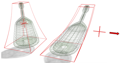

Gizmo
At this sub-object level, you can transform and animate the gizmo like any other object, altering the effect of the Taper modifier. Translating the gizmo translates its center an equal distance. Rotating and scaling the gizmo takes place with respect to its center.
Center
At this sub-object level, you can translate and animate the center, altering the Taper gizmo's shape, and thus the shape of the tapered object.
For more information on the stack display, see Modifier Stack.
Moving the modifier's center changes the gizmo shape.

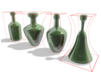

Taper group
Amount
The extent to which the ends are scaled. Amount is a relative value with a maximum of 10.
Curve
Applies a curvature to the sides of the Taper gizmo, thus affecting the shape of the tapered object. Positive values produce an outward curve along the tapered sides, negative values an inward curve. At 0, the sides are unchanged. Default=0.

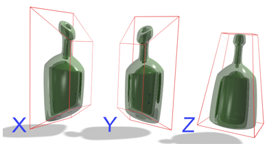

Taper Axis group
Primary
The central axis or spine of the taper: X, Y, or Z. Default=Z.
Effect
The axis, or pair of axes, indicating the direction of the taper from the primary axis. The available choices are determined by the choice of primary axis. The effect axis can be either of the two remaining axes, or their combination. If the primary axis is X, the effect axis can be Y, Z, or YZ. Default=XY.
Symmetry
Produces a symmetrical taper around the primary axis. A taper is always symmetrical around the effect axis. Default=off.
Changing the effect axis changes the effects of the modifier.

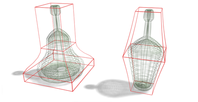

Limits group
The taper offset is applied between the upper and lower limits. The surrounding geometry, while unaffected by the taper itself, is moved to keep the object intact.
Limit Effect
Enables upper and lower limits for the taper effect.
Upper Limit
Sets the upper limit boundaries in world units from the taper center point, beyond which the taper no longer affects the geometry.
Lower Limit
Sets the lower limit boundaries in world units from the taper center point, beyond which the taper no longer affects the geometry.
Left: Limiting the effect of the taper
Right: Using symmetry
