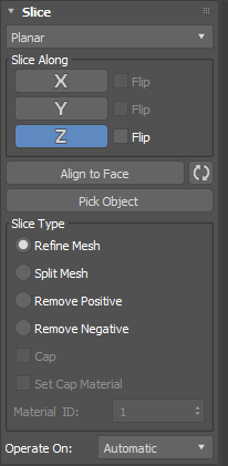

Slice Parameters rollout
Slice Type menu
Choose the slice type, either Planar or Radial.
Slice Along group
X, Y, Z buttons
Slices the object along the selected axes.
Flip (Planar type only)
When enabled, flips the slice to the opposite side of the corresponding axis.
Radial Slice group
This group is only shown when Radial is selected as the slice type.
Angle 1
Sets the minimum angle of the radial slice.
Angle 2
Sets the maximum angle of the radial slice.
Align to Face button
Selects the face used to align the gizmo.
image Reset Gizmo button
Resets the gizmo to its default position.
Pick Object button
Selects a reference object from the scene.
Slice Type group
Selecting a slice type defines how the slice plane will affect the geometry to which it has been applied.
Refine Mesh (Planar type only)
Adds new vertices and edges along the intersection of the geometry with the slicing plane. Faces cut by the plane are subdivided into new faces.
Split Mesh (Planar type only)
Adds a double set of vertices and edges along the plane boundary, producing two separate meshes (one on either side of the slice plane), which you can modify differently if desired. Use this to break a mesh in two.
Remove Positive
Removes the positive portion of the mesh.
Remove Negative
Removes the negative portion of the mesh.
Cap
When enabled, automatically caps any holes in the mesh along the boundary edges.
Set Cap Material
When enabled, automatically caps any holes along any boundary edges set to specific material ID.
Material ID
Sets the material ID to cap.
Operate On
Selects how the slice handles...
