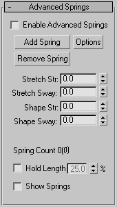

To add custom springs:
  1. Apply Flex to an object and go to the Weights & Springs sub-object level.
    The Flex vertices appear at object vertices in the viewports.
  2. On the Advanced Springs rollout, turn on Show Springs.
  3. Click the Options button and in the Spring Option dialog, choose how you want to add springs. Exit the Spring Option dialog.
  4. Select vertices according to the options.
    For instance, if you want to add one Hold Shape spring between two vertices, select both vertices.
  5. Click Add Spring.
    The new spring or springs appear. Edge springs are blue and Hold Shape springs are red.

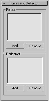

Forces and Deflectors rollout
Forces group
Use these controls to add space warps in the Forces category to the Flex modifier. Supported space warps are:
[list of space warps]
Displays particle space warps applied to the Flex modifier.
Add
Click this, and then select a particle space warp in the viewports to add the effect to Flex. The added space warp displays in the list window.
Remove
Select a space warp in the list and click Remove to remove the effect from Flex.
Deflectors group
Using deflectors with Flex lets object movement be impeded by surfaces. This lets you simulate collisions with soft-body objects. For best results with collisions, in the deflector settings use a low value for Bounce and a high value for Friction.
Supported deflectors are:
[list of deflectors]
Displays deflectors applied to the Flex modifier.
Add
Click this, and then select a deflector in the viewports to add the effect to Flex. The added deflector displays in the list window.
Remove
Select a deflector in the list and click Remove to remove the effect from Flex.
Use these settings when you need a more precise springs setup than is provided by the Simple Soft Body feature. Flex uses two types of spring: edge springs, which create springs only along existing edges, and shape springs, which can exist between any two vertices in the object that are not connected by an edge. In general, add edge springs along existing edges and shape springs between vertices that don't share an edge.
Note: Before using these controls, go to the Weights & Springs sub-object level.
Tip: Additional spring types are available using MAXScript. See the MAXScript Help for details.
Enable Advanced Springs
Makes the numeric controls available for editing, and disconnects the Strength and Sway settings from the Simple Soft Bodies controls. Default=off.
The four numeric Stretch and Sway settings in this rollout are available only when Enable Advanced Springs is on.
Add Spring
Adds one or more springs to the object based on the vertex selection at the Weights & Springs sub-object level and the Spring Option dialog settings.
Note: You cannot undo this action. To delete existing springs, select the endpoints and click Remove Spring.
Options
Opens the Spring Option dialog for determining how springs are added with the Add Spring function.
Remove Spring
Deletes any springs that have both vertices selected at the Weights & Springs sub-object level.
Stretch Str.
Determines the strength of the edge springs; the higher the strength, the less the distance between them can vary.
Stretch Sway
Determines the sway of the edge springs; the higher the strength, the less the angle between them can vary.
Shape Str.
Determines the strength of the shape springs; the higher the strength, the less the distance between them can vary.
Shape Sway
Determines the sway of the shape springs; the higher the strength, the less the angle between them can vary.
Spring Count
Displays the number of edge springs, followed by the number of shape springs in parentheses.
Hold Length
Maintains the length of edge springs within the specified percentage.
Note: This setting, which is applied after the Flex simulation, can affect the object shape, and thus cause collision detection to fail.
Show Springs
Displays edge springs as blue lines and shape springs as red lines. Springs are visible only when a Flex sub-object mode is active.
You can change the spring colors using MAXScript.
