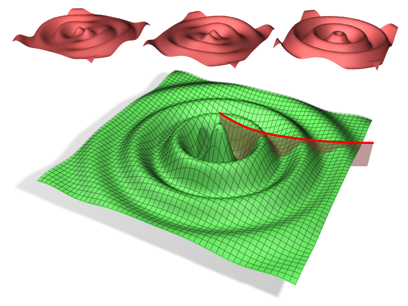

An object with the Ripple modifier applied:
Top (from left to right): Amplitude 1 only, Amplitude 2 only, and both amplitudes
Bottom: Both amplitudes with the Decay effect
