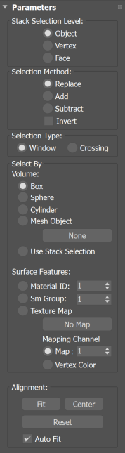

The Parameters rollout appears.
In the Stack Selection Level group, choose Object, Vertex, or Face to specify the kind of geometry you want to work with.
In the Select By group, choose one of the four volume types: Box, Sphere, Cylinder, or Mesh Object.
If you choose Mesh Object, you should then click the None button and select an object to use as the selection volume.
Choose a selection method and type (defined in the following Interface section). You can change these choices as you work, depending on the particular selection you're trying to make.

Volume Select provides three selection levels. Vertex and Face levels put the modifier stack in sub-object selection. You can make one sub-object selection for each Volume Select modifier. You can then toggle the one selection between Face and Vertex level to send either up the stack. Object (top) level lets you modify the whole object while retaining any sub-object selection.
Reverses the entire selection set. Geometry that was unselected becomes selected, and vice versa.
Lets you determine whether selected faces are wholly or partially within the defined volume when you set Stack Selection Level to Face.
These controls let you define the selection with a primitive, a mesh object, or by surface characteristics.
Box/Sphere/Cylinder To define the selection space using a standard primitive-shaped gizmo, choose one of these. You can then scale, rotate, or move the gizmo anywhere around the object.
Mesh Object Choose this option to use another object to define the selection space. After choosing Mesh Object, click the button below it (labeled "None" by default), and then select an object to use as the volume.
Besides mesh objects, you can use patch objects and NURBS objects. In addition, if you turn on Soft Selection rollout > Use Soft Selection, you can use spline objects and particle systems to define the selection. This latter option is quite powerful because the selection changes as the particles move.
[Mesh Object button] Click this button, then select an object to define the selection space. You don't need to choose Mesh Object first, but you do need to choose Mesh Object to use the object as a volume. After you select an object, its name appears on the button. This button is labeled "None" if no object has been chosen.
When active, this option locks your current stack selection. With this button, you can switch between the selection that is being passed into the modifier, or modify that selection with the tools and functionality that already exist within the modifier.
Defines the selection by surface characteristics instead of a geometric volume. While this doesn't have much to do with volume, it was added because Volume Select is a procedural modifier, whereas Mesh Select is explicit. Now, even if your topology changes, Volume Select will consistently select the faces or vertices using a particular material or smoothing group.
Indicate which type of surface characteristic to base selection on by choosing one of the following:
Material ID Specifies a material ID. All faces or vertices using the ID indicated by the spinner value are selected.
Sm Group Specifies a smoothing group. All faces or vertices using the ID indicated by the spinner value are selected.
Texture Map Specifies a texture map from the scene. Click the map button (labeled "None" by default) to open the Material/Map Browser and choose a texture map to use for selection. All faces or vertices using that texture map will be selected. When using the Texture Map option, you can also specify a mapping channel or the vertex color channel using the Map/Vertex Color radio buttons and spinner.
You can also drag and drop a map from a Material Editor sample slot. If the Slate Material Editor is open, you can drag from a map node's output socket, then drop onto this button. You can also drag and drop from a map button in the Material Editor or anywhere else in the 3ds Max interface. When you drop a map onto the map button, a dialog asks if you want the map to be a copy (independent) or an instance of the source map.
To adjust the map's parameters (for example, to assign a bitmap or change the coordinate settings), drag the Map button to the Material Editor, and be sure to drop it as an instance. In the Compact Material Editor, drop the map over an unused sample slot. In the Slate Material Editor, drop it over the active View.
These controls are generally used when the gizmo has been transformed out of its original orientation to the object.
Resizes the gizmo to fit around the object or previous selection in the stack. Maintains any previous rotation.
Recenters the gizmo on the object or previous selection in the stack. Maintains any previous scale or rotation.
Returns the gizmo to its default size and orientation. Cancels the effect of all previous transforms.
When on, automatically adjusts the gizmo size and shape to fit the object as you change the underlying topology (for example, transforming vertices).
These controls, available only at the Vertex stack selection level, let you set a gradual falloff of influence between selected and unselected vertices. See Soft Selection Rollout (Edit/Editable Mesh).
