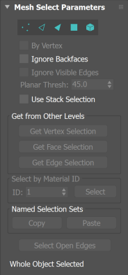

Mesh Select Parameters rollout
Provides buttons for turning different sub-object modes on and off, working with named selections and handles, display settings, and information about selected entities.
The icons at the top of the Selection rollout let you specify the method of sub-object selection.
Clicking a button here is the same as selecting a sub-object level in the modifier stack. Click the button again to turn it off and return to the object selection level.

By Vertex
Selects any sub-objects at the current level that use a vertex you click. Applies to all sub-object levels except Vertex. Also works with Region Select.
Ignore Backfaces
Selects only those sub-objects whose normals make them visible in the viewport. When turned off (the default), selection includes all sub-objects, regardless of the direction of their normals.
Note: The state of the Backface Cull setting in the Display panel doesn't affect sub-object selection. Thus, if Ignore Backfacing is turned off, you can select sub-objects even if you can't see them.
Note: The state of the Ignore Backfaces checkbox also affects edge selection at the Edge sub-object selection level.
Ignore Visible Edges
When turned off (the default), and you click a face, the selection won't go beyond the visible edges no matter what the setting of the Planar Thresh spinner. When turned on, face selection ignores the visible edges, using the Planar Thresh setting as a guide. Enabled when the Polygon face selection method is chosen.
Generally, if you want to select a "facet" (a coplanar collection of faces), you set the Planar Threshold to 1.0. On the other hand, if you're trying to select a curved surface, increase the value depending on the amount of curvature.

Use Stack Selection
When active, this option locks your current stack selection. With this button, you can switch between the selection that is being passed into the modifier, or modify that selection with the tools and functionality that already exist within the modifier.
Get from Other Levels group
Applies selections from one sub-object level to another.
Get Vertex Selection
Selects faces based on the last vertex selection. Selects all faces shared by any selected vertex. The selection is added to the current selection. Available only when Vertex is not the current sub-object level.
Get Face Selection
Selects vertices based on the last face/polygon/element selection. This selection is added to the current selection. Available only when Face/Polygon/Element is not the current sub-object level.
Get Edge Selection
Selects faces based on the last edge selection. Selects those faces that contain the edge. Available only when Edge is not the current sub-object level.
Select By Material ID group
Selects faces based on their material ID.
ID
Set the spinner to the ID number you want to select, and then click the Select button. Press Ctrl while clicking to add to the current selection, or press Alt to remove from the current selection.
Named Selection Sets group
These functions are primarily for copying named selection sets of sub-objects between similar objects, and between comparable modifiers and editable objects. For example, you can apply a Mesh Select modifier to a sphere, create a named selection set of edges, and then copy the selection to a different sphere that's been converted to an editable mesh object. You can even copy the selection set to a different type of object, because the selection is identified by the entities' ID numbers.
The standard procedure is to create a selection set, name it, and then use Copy to duplicate it into the copy buffer. Next, select a different object and/or modifier, go to the same sub-object level as you were in when you copied the set, and click Paste.
Note: Because sub-object ID numbers vary from object to object, the results of copying named selection sets between different objects can be unexpected. For example, if the buffered set contains only entities numbered higher than any that exist in the target object, no entities will be selected when the set is pasted.
Copy
Places a named selection into the copy buffer.
Paste
Pastes a named selection from the copy buffer.
Select Open Edges
Selects all edges with only one face. In most objects, this will show you where missing faces exist. Available only at the Edge sub-object level.
[selection information]
At the bottom of the Mesh Select Parameters rollout is a text display giving you information about the current selection. If 0 or more than one sub-object is selected, the text gives the number and type selected. If one sub-object is selected, the text gives the ID number and type of the selected item.
Note: When the current sub-object type is Polygon or Element, selection information is given in faces.
Soft Selection rollout
These controls let you set a gradual falloff of influence between selected and unselected vertices. See Soft Selection Rollout (Edit/Editable Mesh).
