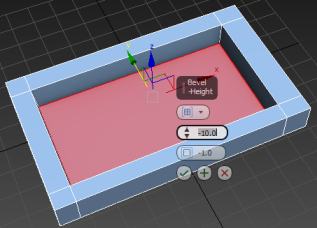

  6. Go to the Polygon sub-object level, select the inside polygon on the top of the box, and extrude it inward about 10 units. Exit Extrude mode.

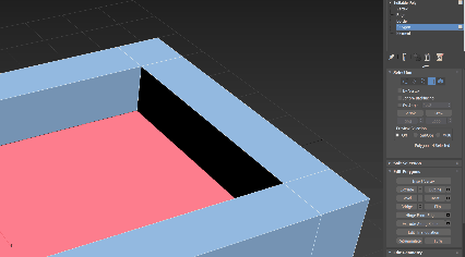

  3. Zoom into a corner to better see the results. As you can see, the four edges have been chamfered, with even, connected corners. The output is the result of the Uniform option, which is the default Mitering setting on the Corner Options rollout.

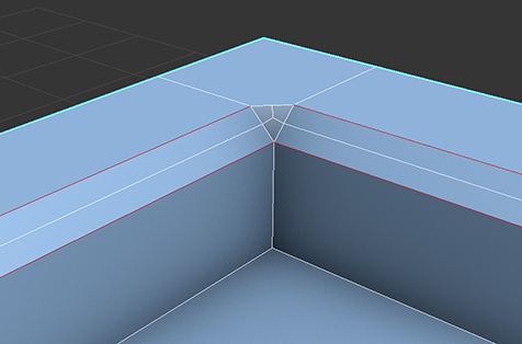

  6. Under Corner Options, set Mitering to Tri, which replicates the legacy Standard option of previous versions.
    Note that the polygons at the corners are now triangles. Triangular polygons can lead to unpredictable results when modeling, so it's better to work with quads whenever possible.

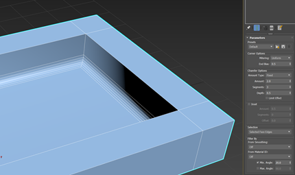

Part 3: Change Selection Options
  1. On Corner Options rollout, enable Uniform mitering again, and then examine the Selection drop-down list.
    Currently Selection is set to From Stack, which means that the chamfer is applied to whatever selection exists at the active sub-object level of the object to which the modifier is applied. But what happens if no sub-object level is active?
  2. To see this, in the modifier stack, click the Editable Poly item.

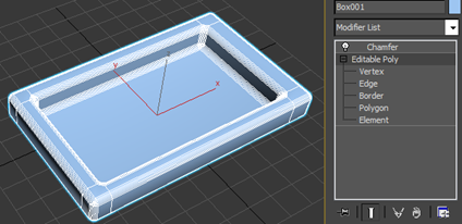

    The stack display updates to show that the Edge level is active.
  3. Make sure the Show End Result toggle below the stack is on ( image) and click either the Edge or the Editable Poly item in the stack display.
    This sets the object to Object level, with the result that the chamfering is applied to every edge. This is standard behavior.
    Although Edge is no longer the active sub-object level on the stack, the edge selection still exists and is available to Chamfer.
  4. On the modifier stack, click the Chamfer entry, then set Selection to Selected Edges.
    The chamfering is once again limited to the edge selection.
    The face selection made earlier is also available to Chamfer.
  5. Set Selection to Selected Face Edges.
    This applies the chamfering to all edges of the polygon selection on the stack, including the "inside" edges between adjacent selected polygons. This produces chamfering of the inner vertical edges.
    If you prefer to chamfer only the inner horizontal edges, you can use a different option.

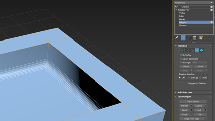

  6. Select Editable Poly again and click on the Polygon button.
  7. Turn off Show End Result ( image) to better see your selection. Then select one of the inside walls of the box and hold Shift and click the face next to it. This will select the entire loop of faces.

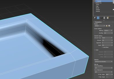

  8. Go back to the Chamfer modifier and set Selection to Selected Faces Border.
    A border comprises only edges on the perimeter of each contiguous polygon selection. So with the Selected Faces Border option, interior edges such as the vertical corners are not chamfered.

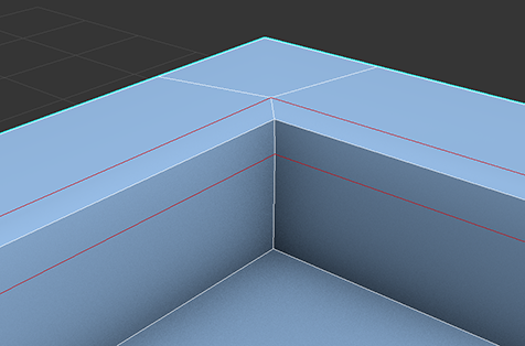

Part 4: Use Crease Weights to Drive Chamfering
  1. From the Chamfer Options group, set the Min Amount to 0 and the Max Amount to 1.
  2. In the stack, select Editable Poly and under Selection click Faces.
  3. Select the four top faces of the box.
  4. Hold Shift and under Selection click Edges to select the border edges of all the selected faces.
  5. From the Edge Properties group in the Edit Edges rollout, set the Crease Weight to 0.1.
  6. Repeat steps 4 and 5 to select the border edges underneath the box, and then repeat step 6 to set the Crease Weight to 1.
  7. Exit Edge mode and in the stack, click on Chamfer.
  8. From the Chamfer Options group, adjust the Min Amount and Max Amount to see the effect on the chamfering by the newly applied crease weights.
  9. To learn more about Chamfer, experiment with the remaining settings. These are all explained in the Chamfer Modifier Reference topic.
