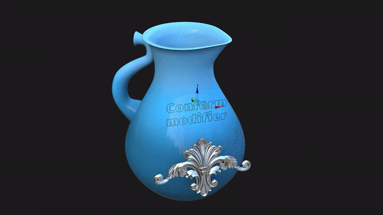

The new Conform modifier lets you project objects onto other surfaces using two methods: Shrink Wrap and Volume.
Modify panel > Make a selection > Modifier List > Object-Space Modifiers > Conform
The Conform modifier lets you move a spline or mesh onto the surface of one or more other meshes.
The Conform modifier performs actions parametrically, letting you change the relationship between the conform object and the target surface after the initial conform operation has been performed. This lets you manipulate the look and feel of your model without any explicit modeling, like bending or shaping. As a result, you save time because basic modeling steps, like roughing out geometry and performing manual refinements, are eliminated.
You can also animate your deformations created with the Conform modifier. For example, a conform object can be animated as it moves across a target surface.
Two projection methods, Volume and Shrink Wrap, control how the spline or mesh (the conform object) is moved onto the surface of the other mesh(es) (target object(s)):
Volume: Tries to preserve the overall shape of the conform object after it's projected onto the target mesh.
Example: Attaching a flange to a pipe.
The Volume method enables the base of the flange to conform to the pipe, without deforming the top portion of the flange.
Shrink Wrap: Shrinks the entire conform surface around the target, like wrapping a piece of cellophane (the conform object) around another object (the target object). As a result, the volume of the conform object is not preserved. Between the two different methods, Shrink Wrap is the most commonly used.
