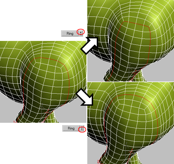

Expands an edge selection by selecting all edges parallel to the selected edges. Ring applies only to edge and border selections.
Shift +clicking another edge in the same ring.
Ring selection adds to the selection all the edges that are parallel to the ones selected originally.
[Ring Shift]The spinner next to the Ring button lets you move the selection in either direction to other edges in the same ring; that is, to neighboring, parallel edges. If you have a loop selected, you can use this function to select a neighboring loop. Applies only to Edge and Border sub-object levels.
Left: Original loop selection
Upper right: Ring Shift up moves selection outward (from center of model).
Lower right: Ring Shift down moves selection inward (toward center of model).
