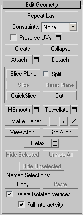

At the editable poly Border sub-object level, you can select single and multiple borders and transform them using standard methods. This topic covers the Edit Geometry and Edit Borders rollouts; for other controls, see Editable Poly.

For detailed descriptions of these controls, see Edit Geometry Rollout (Polymesh and Edit Poly).
