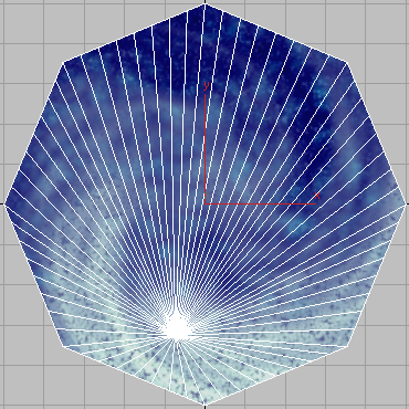

Original model
Vertices: 557

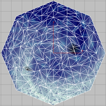

Crunch Borders
ProOptimizer optimizes the object without considering whether edges and faces lie on borders or not.
Crunch Borders active
Vertex % = 50.0
Vertices = 278
Faces are reduced but object borders are not preserved.

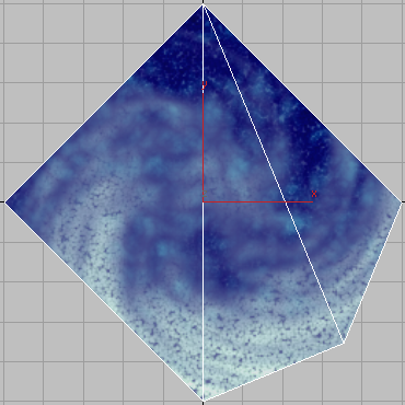

Protect Borders active
Vertex % = 1.0
Vertices: 5
Decreasing Vertex % or Vertex Count can cause borders to become distorted.

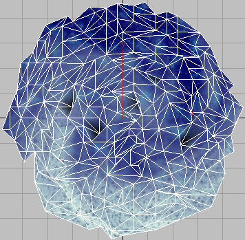

Exclude Borders active
Vertex % = 10.0
Vertices: 65
At low Vertex % values, Exclude Borders can interfere with optimization.
