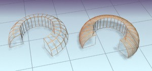

Sets the number of divisions, or steps, 3ds Max uses between each built-in section's vertices. Splines with tight curves require many steps to look smooth while gentle curves require fewer steps. Range=0 to 100.
Left: The quarter-round section is set to zero steps.
Right: The same section on the right is set to four steps.

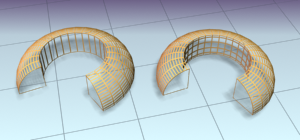

When on, removes unneeded steps from straight segments in the spline. Default=on.
Note: Optimize is not available when Adaptive is on. image Left: Optimize is on for the left-hand sweep. Right: Optimize is off for the right-hand sweep.
