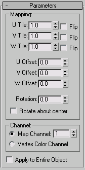

Interface
Mapping group
U Tile, V Tile, W Tile
Alter the tiling along any of the three coordinate axes.
Flip
Reverses the direction of the map along the specified axis.
U Offset, V Offset, W Offset
Move the map in the direction of the specified axis coordinate.
Rotation
Rotates the map.
Rotate About Center
When active, the map rotates about the center of the object. If this is applied to a sub-object selection, it uses the center of that selection.
When this is turned off, the map rotates about the corner of the U and V coordinate gizmo.
Channel group
Specifies whether to apply the transform to a mapping channel or a vertex color channel, and which channel to use. For more information on these channels, see UVW Map Modifier.
Apply To Entire Object
If the UVW Xform modifier is applied to an active sub-object selection, such as face or patch, this switch controls whether the settings of the UVW Xform modifier affect only the original sub-object selection or affect the entire object.
