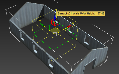

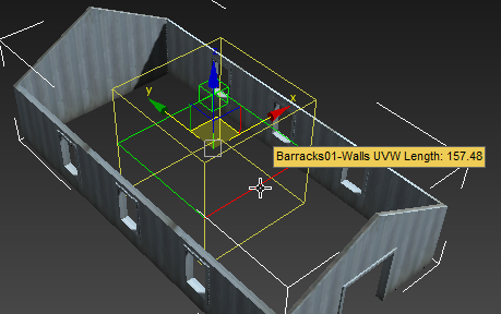

Adjusting an edge manipulator for Box mapping
Adjusting the height manipulator for Box mapping
When you use the manipulator to adjust the Height, the gizmo remains centered on the Length/Width plane, so the Height adjustment scales the mapping.

To use manipulators to control the width and length:
  1. On the Modify panel, choose the UVW Map modifier in the stack display.
    You can also be at the Gizmo level of the modifier.
  2. On the main toolbar, click to turn on Select And Manipulate.
    Green edges appear along the sides of the UVW Map modifier's gizmo. An edge turns red when you move the mouse over it.
  3. Drag an edge of the gizmo to adjust the width or length.
    A tooltip shows the new width or length value.

    For 3D mapping types, a green cube appears at the top of the UVW Map modifier's gizmo. The cube turns red when you move the mouse over it.
  3. Drag the cube to adjust the height of the gizmo.
    A tooltip shows the new tiling value in the vertical dimension.

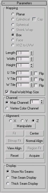

Parameters rollout
Mapping group
Determines the type of mapping coordinates used. Different kinds of mapping are distinguished by how the map is geometrically projected onto the object and how the projection interacts with the object's surfaces.
Note: When Real-World Map Size is on, only the Planar, Cylindrical, Spherical, and Box mapping types are available. Similarly, if one of the other options (Shrink Wrap, Face, or XYZ To UVW) is active, Real-World Map Size is unavailable.

Length, Width, Height
Specify the dimensions of the UVW Map gizmo. The default scale of the mapping icon is defined by the largest dimension of the object when you apply the modifier. You can animate the projection at the gizmo level. Note the following facts about these spinners:
U Tile, V Tile, W Tile
Let you specify the dimensions of the UVW map, for tiling the image. These are floating-point values, which you can animate to displace the map's tiling over time.
Flip
Reverses the image about the given axis.
Real-World Map Size
When on, uses real-world mapping for texture-mapped materials that are applied to the object. The scaling values are controlled by the Use Real-World Scale settings found on the applied material's Coordinates rollout. (Both Real-World Map Size and Use Real-World Scale should be either off or on at the same time.) Default = off.
When on, the Length, Width, Height and Tiling spinners are unavailable.

Acquire
Effectively copies the UVW coordinates from other objects When you pick an object from which you want to acquire UVWs, a dialog prompts you whether the acquire should be done in an absolute or relative fashion.
If you choose Absolute, the acquired mapping gizmo is positioned exactly on top of the mapping gizmo you pick. If you choose Relative, the acquired mapping gizmo is positioned over the selected object.
Display group
This setting determines whether and how mapping discontinuities, also known as seams, appear in the viewports. The seams appear only when the Gizmo sub-object level is active.
Tip: The default seam color is green; to change it, go to Customize menu > Customize User Interface > Colors tab, and then from the Elements drop-down list, choose UVW Map.
The options are:
