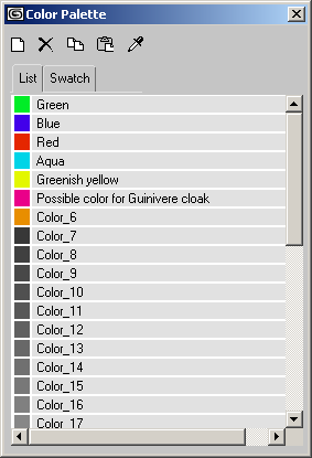

Color Palette (VertexPaint Modifier)
The VertexPaint modifier's Color Palette lets you create and maintain color palettes for use with vertex paints. You can save or load palettes as Color Clipboard (CCB) files, which are also used by the Color Clipboard utility.

Interface
image New
Click to add a new color to the palette.
The only limit to the number of colors a palette can have is a file size or memory limitation.
image Delete
Click to delete the active color.
image Copy
Click to copy the active color.
image Paste
Click to paste a copied color to the active swatch.
image Color Picker
Highlight a color in the palette, turn this button on to activate the picker, then drag anywhere on the Windows desktop. The color is picked when you release the mouse. (See the procedure “To use the color picker,” above.)
List panel
Displays the colors in the palette, along with their names.
Swatch panel
Displays the colors in the active palette. The swatch panel doesn't list the names of colors, but each color's name appear as a tooltip when the mouse is over the swatch.
