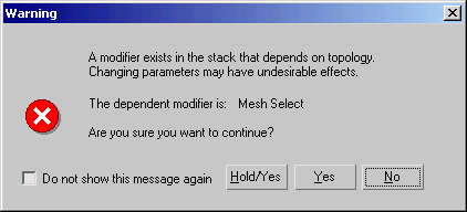

Many other types of modifiers, however, perform operations on the explicit topology of sub-object selections. The Edit modifiers and Select modifiers are examples. When a topology-dependent modifier is present on the stack, you can affect its results adversely if you visit previous stack operations and change the number or order of sub-objects (such as faces or vertices) in the selection. If you attempt this, a warning alerts you to the situation:
You can safely edit the stack beneath the topology-dependent modifier, as long as you do not add or remove sub-objects from the selection on which it operates.
Note: If you turn on "Do not show this message again" and then click either Hold/Yes or Yes, the subsequent default behavior is to continue without performing a Hold operation; that is, the same as clicking Yes. If you turn on "Do not show this message again" and then click No, the process is halted and the message remains in effect; that is, it displays again in subsequent such situations.
