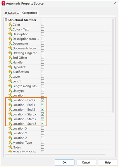

Structural Member Coordinates
In AutoCAD Architecture and MEP 2027, the start and end X, Y, Z coordinates for structural members can now be added as an automatic property source within the property set definition.
With this enhancement, structural member start and end coordinate properties can be included in a schedule table and exported to a Microsoft Excel spreadsheet or tab-delimited text (TXT) files.
