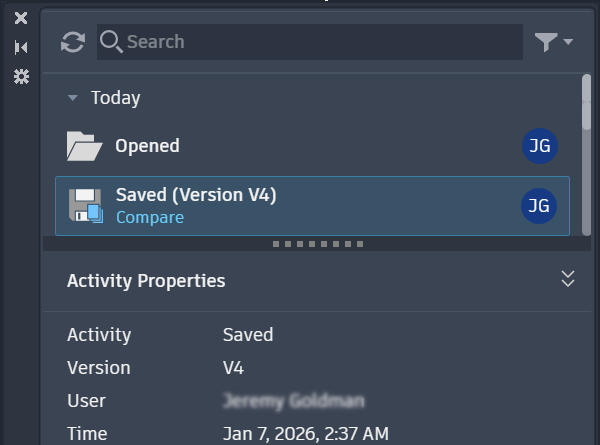

View Activity Insights for the Current Drawing
  1. Click View tab > History panel > Activity Insights. Find
    The Activity Insights palette opens, displaying activity for the current drawing.
    Note: Activities are logged even when the Activity Insights palette is closed. All activities are displayed the next time the palette opens.
  2. Click an activity to see more detail in the Activity Properties panel.
Note: Some activities will not appear in the palette until the drawing is saved.

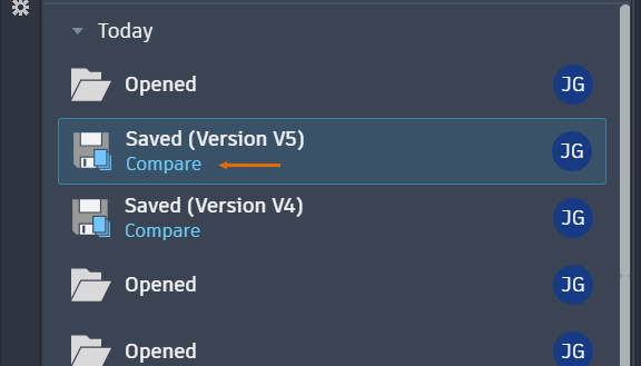

Track and Compare Different Versions
When you use Activity Insights with a supported cloud storage provider such as Forma Data Management, Google Drive, OneDrive, Box, or Dropbox, a new version of each drawing is recorded each time you save. Click Compare on each version tile to easily compare previous and current versions.
Note: If you have a layer that is turned off or frozen in your current drawing, it will not become part of the comparison result.
By selecting Saved in the Activities filter, you can isolate version activity. To filter further, use the Time and Users filters.

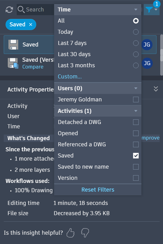

  3. To filter, select the filter icon, which will allow you to filter by Time, Users, and/or Activities.
    • Time: Select the time interval from where you'd like to see activities. Click Custom... to select a specific date or range of dates from the calendar.
    • Users: Select the user(s) whose activities you'd like to see. Only users who have activities are included in the list.
      Note: AU stands for anonymous user for activities outside AutoCAD.
    • Activities: Select from the list of activity types for the current drawing.
    Note: You can select multiple options from the Users and Activities filters.

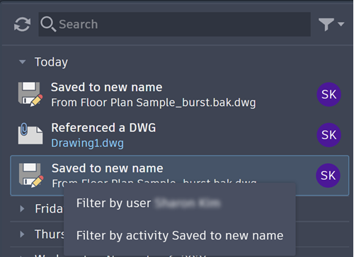

  4. You can also access filters easily by right-clicking any activity. This action allows you to filter by the user who did the activity, or filter by the same type of activity.
