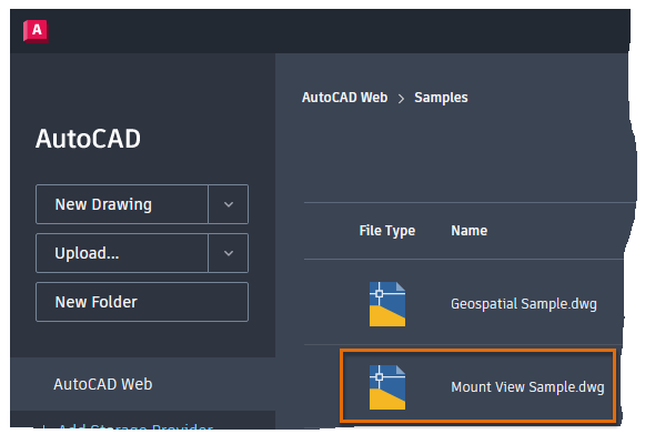

  3. On the main page, choose the drawing file you want to open.

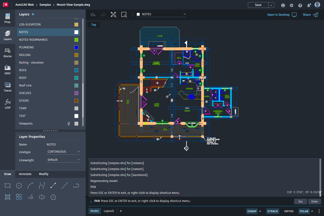

  4. After the file has been opened, you can manipulate the view of the drawing by performing a:
    • Drag to pan the current view
    • Wheel scroll to zoom in or out

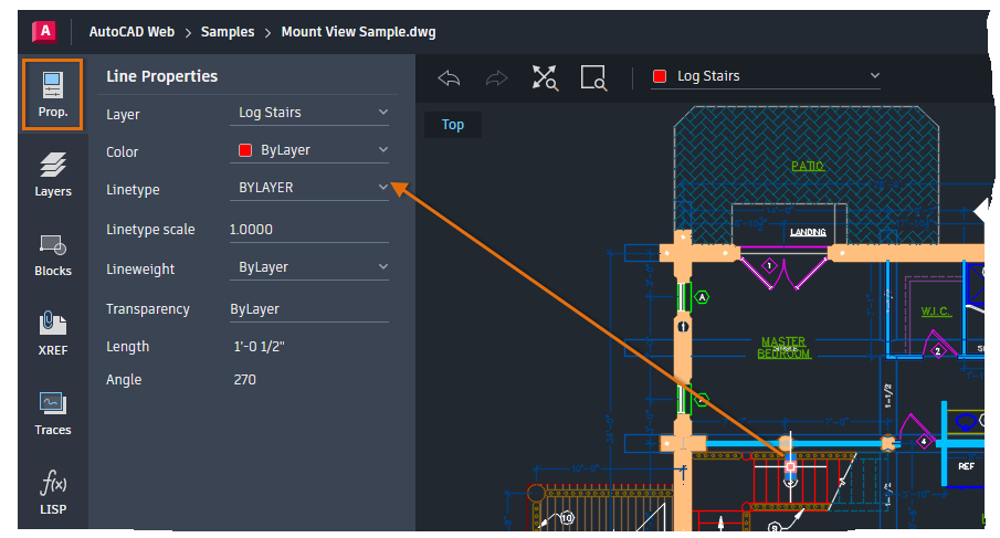

  5. On the left, click Properties tab and then select an object in the drawing to view and edit that object’s properties.

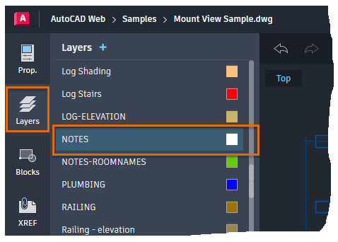

  6. Click the Layers tab and choose a layer to set it current.

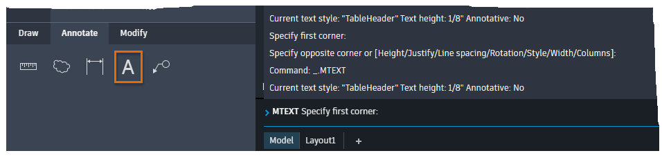

  7. Click a tool on the ribbon and follow the prompts that are displayed in the Command Line window.
  8. In the upper-right, click Save to save your changes if desired.

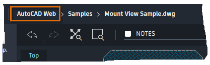

  9. Close the drawing by clicking Home along the top.
    If you didn’t save your changes, you will be prompted to return to the drawing or discard your changes.

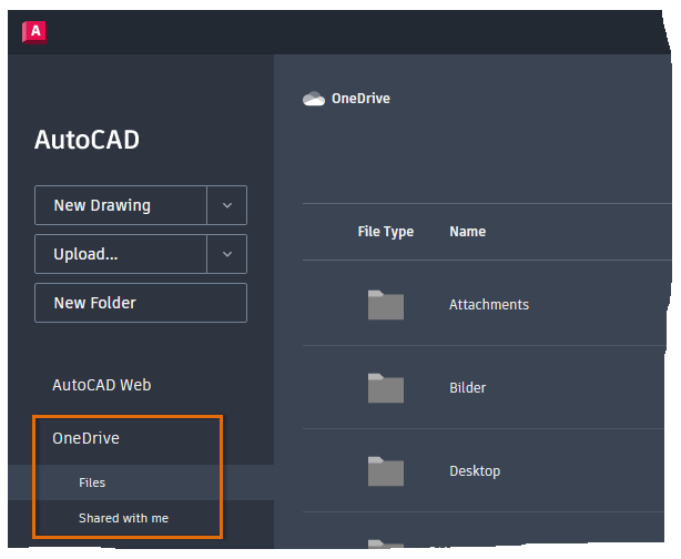

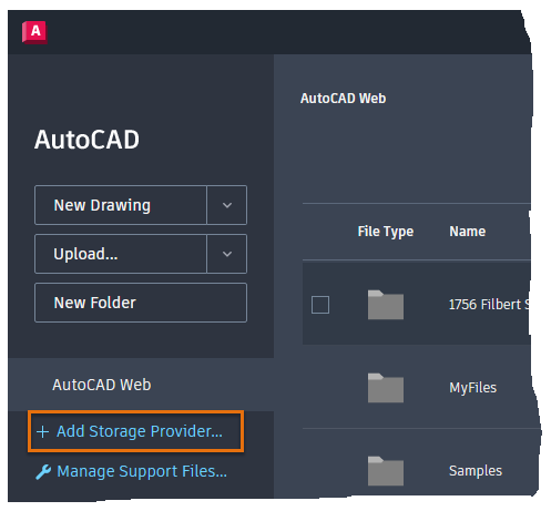

Add a Cloud Storage Provider to the AutoCAD web app
  1. Sign into the AutoCAD web app.
  2. On the main page, click Add Storage Provider.
  3. From the list of supported sources, click Add next to your cloud storage provider.
  4. Follow the on-screen messages and sign in using your account credentials.

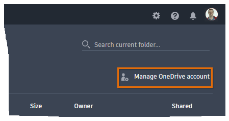

Note: To disconnect from a cloud storage provider, select the cloud storage provider on the left. Then click the Edit Account button on the right and click Disconnect.
