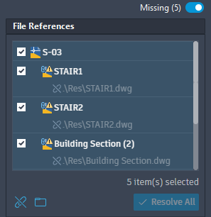

Missing Toggle
Toggles between the Display All Attached References and Display Missing References Only states. When the Display Missing References Only state is current, you can use the Connected References workflow to update the paths of missing external drawing references (xrefs) by manually specifying a new path for references or accepting a suggested path for references in the current drawing when opened from an Autodesk project in Forma Data Management.
Supported missing references include:
  • External drawing references (xrefs)
  • Data references (DREFs) which are available in Autodesk Civil 3D only

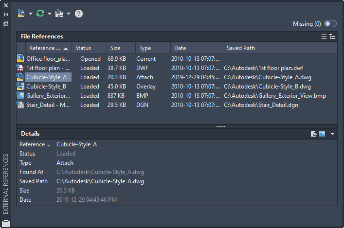

File References Pane (Display All Attached References State)
Displays all the references that are attached to the current drawing.
Tip: Click the reference's name slowly twice to edit it or use the Details pane to edit the selected reference's name and other attachment properties.

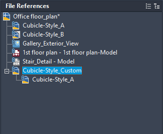

List and Tree View buttons
Click the buttons to switch between list and tree view.
List View
The listed information includes the reference name, status, file size, file type, creation date and saved path.
Reference Name
The reference name column always displays the current drawing as the first entry, followed by additional attached files that are listed in the order they were attached.
Status
The status of the referenced file:
  • Loaded - The referenced file is currently attached to the drawing.
  • Unloaded - The referenced file is unloaded from the drawing. When you unload a referenced file, the referenced file is not displayed, but can be displayed again using Reload.
  • Not Found - The referenced file no longer exists in the valid search paths.
  • Unresolved - The referenced file cannot be read.
  • Orphaned - The referenced file is attached to another file that has an Unresolved, Unloaded or Not Found status.
  • Unreferenced - The referenced file is no longer in use; all instances have been erased from within the drawing.
  • Needs Reloading - The reference file has been updated/re-saved while the host drawing is open. This status is displayed at the same time with the balloon notification, in the status bar, indicating that the external reference file has changed.
  • Comparable - The reference file has changed and the differences between what is currently loaded and on disk can be compared.
  • In Compare - The reference is currently being compared for differences.
Size
The size of the attached file reference.
Type
The file type of the referenced file. Drawing (Xref) files display as attachments or overlays, raster images show their file format; and DWF, DWFx, DGN, and PDF underlays are listed as their respective file types.
Date
The date when the referenced file was created or last saved.
Saved Path
Displays the path that is saved with the drawing when the referenced file is attached.
Tree View
The top level of the tree view always shows the current drawing. Referenced files appear at the next level. Referenced files that contain their own nested file references can be opened to show deeper levels. When making selections in tree view, only one file reference can be selected at a time.
File References Pane (Display Missing References Only State)
Displays only the missing external referenced drawings (xrefs) in the current drawing.
Tree View
The top level of the tree view always shows the current drawing and the missing references appear at the next level. Each missing reference shows its last saved path.
When one or more missing references are selected you can detach them from the current drawing or update their paths manually or with the suggested paths of the references stored in Forma Data Management.
Switch to All References
This option is displayed when there is no missing references in the current drawing. When clicked, the Display All Attached References state is enabled and you can see all of the references attached to the current drawing.
Detach
Removes the selected missing references from the current drawing.
Update Paths
Specifies a new path for the selected missing references.
Note: Only the path of the reference is updated; the referenced file is not moved.
Resolve Selected
Accepts the suggested paths for the selected missing references.
Details/Preview Pane
Displays information or a preview image of a selected reference.
Detail Display and Thumbnail Preview buttons
Click the buttons to switch from the detail display to a thumbnail preview.
Details Pane
When displaying the Details mode, properties for the selected file reference are reported. Each file reference has a core set of properties and some file references, like referenced images, display properties specific to the file type. The core set of details include the reference name, status, file size, file type, creation date, saved path, found at path and file version, if the Autodesk Vault client (not available in AutoCAD LT) is installed. Some of the properties can be edited.
Reference Name
Displays the file reference name. This property can be edited only if single file references are selected. The reference name shows *Varies* if multiple file references are selected. This property is editable for all the file references.
Status
Shows whether the file reference is loaded, unloaded or not found. This property cannot be edited.
Size
Shows the file size of the selected file reference. The size is not displayed for file references that are unloaded or not found. This property cannot be edited.
Type
Indicates whether the file reference is an attachment or overlay, the type of image file, a DWF/DWFx underlay, DGN underlay, PDF underlay, or an NWD/NWC coordination model. This property cannot be edited.
However, if the file reference is a DWG xref, the Attach or Overlay property can be toggled.
Date
Displays the last date the file reference was modified. This date is not displayed if the file reference is unloaded or not found. This property cannot be edited.
Found At
Displays the absolute path of the selected file reference. This property cannot be edited.
Saved Path
Displays the save location of the selected file reference. This is where the referenced file is saved and is not necessarily the same as the Found At location. Clicking the Open button displays the Open dialog box where you can select a different path or file name. You can also type directly into the path field. These changes are stored to the Saved Path property if the new path is valid.
File Version
Displays the file version property defined by the Autodesk Vault client. This property is displayed only when logged in to Vault.
Last Modified (DREF Reference Only)
Displays the last date the data reference file was modified.
This value is read-only and not displayed when the file reference is unloaded or not found.
Last Modified By (DREF Reference Only)
Displays the last user that modified the data reference file.

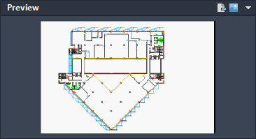

Preview Pane
The preview image is displayed only when a single file reference is selected from the File References pane. There are no other controls for this data pane. When no reference file is selected, the preview pane displays a solid grey field. If there is no preview available, the text “Preview not available” is displayed in the center of the pane.
