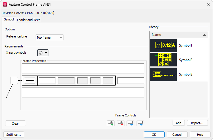

Feature Control Frame
The Feature Control Frame ANSI dialog box includes the latest standard revision, ASME Y14.5 – 2018 R(2024), providing the most up-to-date notation and requirements. The dialog box supports multi-frame functionality, allowing the addition of more frames as required, along with a field for inline notes. The Insert Symbol library has new symbols under the additional symbols category.

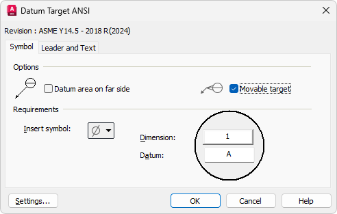

Datum Target
The Datum Target ANSI dialog box includes the latest standard revision ASME Y14.5 – 2018 R(2024). The dialog box now supports a new option to insert a movable target symbol.

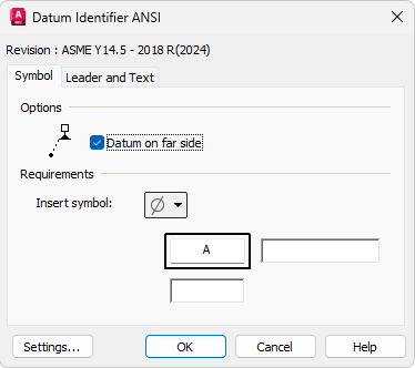

Datum Identifier
The Datum Identifier ANSI dialog box includes the latest standard revision ASME Y14.5 – 2018 R(2024). The dialog box now provides the option to insert symbols on the far side. Under Requirements, datum note, and thread note fields are provided along with the Insert symbol option.
