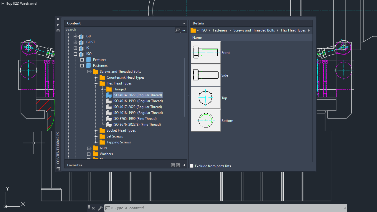

More than 780 mechanical standard parts are updated to the latest revision in the content library of AutoCAD Mechanical 2027. These parts are available in English and all other supported languages in AutoCAD Mechanical.
The updated content includes:
- Metric ISO-Thread–Tapped Holes (Through): ISO 262: 2023 (Regular Thread)
- Thread Blind–Tapped Holes (Blind Standard Runout): ISO 262: 2023 (Regular Thread)
- Hexagon Head Bolt: ISO 4014: 2022 (Regular Thread)
- Hexagon Head Bolt: ISO 4017: 2022 (Regular Thread)
- Hexagon Nut: ISO 4032: 2023 (Regular Thread)
- Hexagon Nut: ISO 4035: 2023 (Regular Thread)
