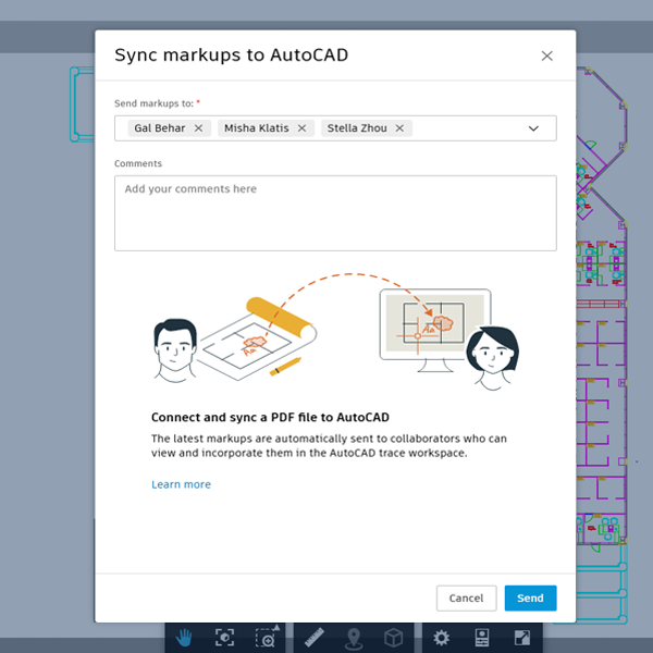

- In
Forma Data Management, in the Files tool, open a PDF with published markups.
- Select Sync markups to AutoCAD.
- Choose who will receive the markups and add any comments.
- Click Send.
