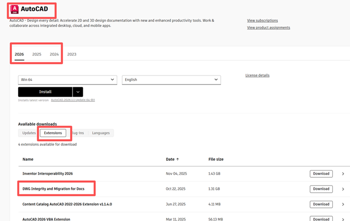

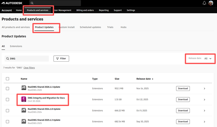

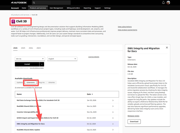

The DWG Integrity and Migration for Docs installer is available on manage.autodesk.com and is accessible only to customers with a valid AutoCAD or Civil 3D 2024-2026 license.
  • The installer can be found on the Civil 3D Extensions page.
  • The AutoCAD Extensions page.
  • And on the Product Updates page.
