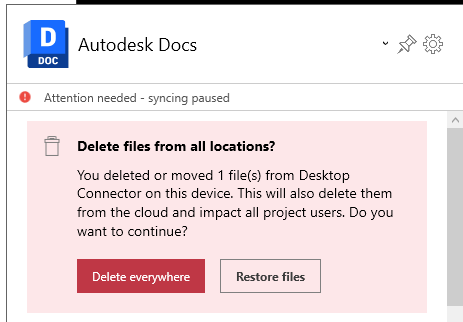

Home Screen Delete Notifications
Desktop Connector highlights delete notifications on the home screen for Docs and Fusion connectors. Whenever you delete files, these notifications will appear to provide a clear confirmation, allowing you to choose whether to proceed with the deletion action or not.
The Home Screen will remain open and syncing will be paused when you have pending notifications that need to be resolved. For a full explanation of deletion workflows and recovery options, see Recover Deletions.
Home screen delete notification

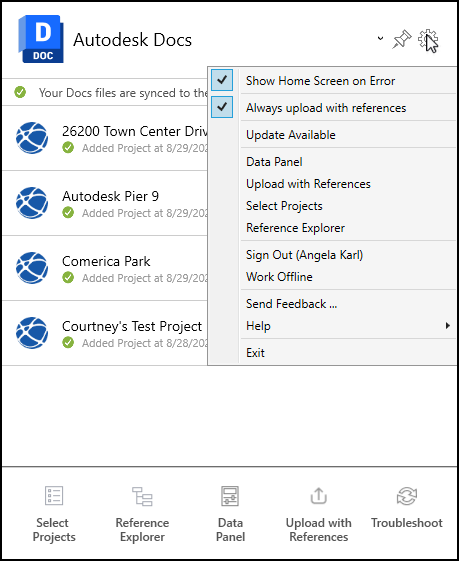

Shortcut Menu Options
home screen menu options
The following table details the available menu options including the scenario when they're only available in certain connected drives. Click the help topic links to learn more detail.
Menu option Action Help topic link
Update Available Enabled when there is an update for Desktop Connector available Update Desktop Connector
Show Home Screen on Error Checkbox setting to automatically show the Home Screen when sync errors occur (enabled by default) Smart Error Notification
Always upload with references* Checkbox setting to automatically trigger Upload with References workflow when dragging files into connectors Automatic Upload with References
Data Panel* View detailed file information and cloud-based properties for files in your Autodesk Docs and Fusion connected drives from Windows File Explorer Data Panel
Upload with References* Enhanced workflow for uploading files and their references to Fusion and Docs connectors Upload with References
Select Projects* Add or remove projects from File Explorer Manage Projects
Reference Explorer Analyze and view references to troubleshoot errors including missing or circular references About Reference Explorer
Work Offline Work with your connector content without being connected to your cloud data Docs - Work Offline
Drive - Work Offline
Fusion - Work Offline
Sign Out or Sign In Sign in and out of Desktop Connector Sign In and Out
Send Feedback Rate your experience with Desktop Connector, and send the team a message about your experience Send Feedback
Help Access this help site Desktop Connector Help
Exit** Stops Desktop Connector running and removes the tray icon Exit Desktop Connector
About Software credits Software Credits and Current Version
Check for Drives Adds connectors if your access to data sources changes and you can't view the relevant drive yet Connectors
Desktop Analytics Opt in or out of data collection Data Analytics Collection
Diagnostic Logs Generate diagnostic logs to analyze any unexpected behavior of Desktop Connector Reporting and Diagnostic Logs
Create Viewable* Manually generate a viewable in Autodesk Docs for selected files Docs - Manage Files and Folders
