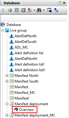

The Overview GeoExplorer is a tree view object identifiable by a GeoExplorer icon and is automatically generated by InfoWorks ICM when a manifest deployment is saved or deployed.
The Overview GeoExplorer appears as a child of the related manifest deployment object in the Explorer window:
Opening the Overview GeoExplorer
To open the Overview GeoExplorer:
  1. In the Explorer Window and locate the manifest deployment of interest.
  2. Click the button to expand the view and reveal the associated icon.
  3. Right-click the Overview tree object and select Open from the popup menu. Alternatively, drag and drop the GeoExplorer icon onto the background area outside the explorer window.
