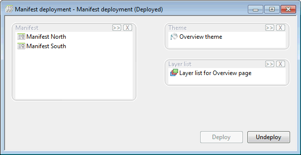

A Manifest Deployment contains a collection of manifests which will be available for display in ICMLive Operator Client, and defines how these manifests are displayed in its Overview Page.
Manifest Deployment
Note: Deploying / undeploying a manifest deployment can be permissioned and therefore the Manifest Deployment dialog (described below) may be unaccessible or read-only to users who have not been granted rights to perform this operation.
Once a manifest deployment is saved or deployed, an Overview GeoExplorer is automatically generated by InfoWorks ICM and appears as a child of the related manifest deployment object in the Explorer window.
The Overview GeoExplorer is used to generate the Overview Page in the ICMLive Operator Client. This page is displayed according to a theme specified in the manifest deployment, or the default theme if you do not specify one. If you have included a layer list, any background layers will also be displayed in the Overview Page.
The items in the Manifest Deployment dialog are described below.
See Working with Database items for details on how to create, open, edit, save or delete manifest deployments. And Working with Manifest Deployments for details about differences in their behaviour, as well as outlines for defining and validating a manifest deployment.
Dialog description
Items Description
Manifest
The manifests included in this manifest deployment. At least one manifest must be included.
Theme
The theme to be used for displaying for the Overview GeoExplorer.
You can setup a GeoExplorer theme for areas of interest (AOI), AOI alert counts or AOI alert priorities. This theme will be used on the Overview Page of the ICMLive Operator Client to highlight areas of interest which contain alerts for the most recent simulation.
If no theme is specified in this droptarget, the default theme is used.
Layer list
A layer list.
The specified layer list will be used on the Overview Page of the ICMLive Operator Client to provide background layers.
Deploy
Deploys the manifest deployment.
Deploying it saves the object, validates it and makes it available for selection in ICMLive Operator Client. It also results in the Innovyze Live Server processing the manifests and performing ICMLive runs according to each manifest run schedule.
Undeploy
Undeploys the manifest deployment.
Undeploying it is a way of temporarily isolating it, either because the user no longer wants to run it, or because it needs editing.
