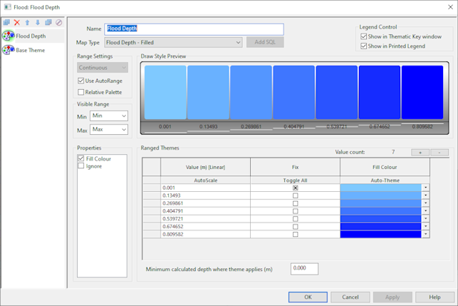

  3. Click Edit in the Theme column for the Flood object layer. The Layer Theme Editor is displayed:
  4. The default Flooding theme is called Flood Depth and is based on flood depth. The default Map Type is Filled but other types are also available (see table below). Fill contours of flood depth values have been auto-themed so the Draw Style Preview shows a graduated set of colours going from light blue for low flood depths to dark blue for high flood depths.
    Note: You cannot create additional Ground Model and Flood sub themes as there is only one parameter to theme (z and flood depth, respectively). However, you can choose between different map types (Filled, Line, Show Layers and Transparent).
  5. Change the name of the Flood Depth theme (Name box) if required and select a different map type in the Map Type dropdown.
  6. Tip: The provided Flood theme will only be editable if a simulation and a ground model have both been loaded onto the GeoPlan.
  7. Setup your contour parameters following the instructions detailed in the Managing Themes topic and click OK to commit your changes. See Flood Levels Theme Data Fields table below.
Section
Options
Map Type
The options available in this section depend on the type of Ground Model (Grid or TIN) being used.
Option
Description
Filled
Flood ExtentsThematic displayed as filled contours. GIS layers will be obscured.
Line
Flood Extents displayed as Line Contours.
Show Layers
Displays GIS layers on top of Flood Extents Thematic displayed as filled contours.
Transparent
Flood Extents Thematic is displayed as transparent filled contours allowing GIS layers to be seen.
Range Settings
The only available option is Continuous. This will display the Flood Extents based on a series of ranges of depth.
Option
Description
Use AutoRange
With this option checked, InfoWorks ICM automatically re-scales the values if you open a different network or simulation.
Relative Palette
InfoWorks ICM will apply the selected set of colours in the Fill Colour column of the Ranged Themes grid to the part of the Flood Depth currently being viewed on the GeoPlan. Values are automatically re-scaled when the GeoPlan zoom is changed.
Visibility Range
The Min and Max boxes determine the map scale/zoom level at which the flood mapping is visible.
Ranged Themes
See Layer Theme Editor for details on how to set up themes using the controls in the Ranged Themes grid.
Two important points:
  • The more ranges that are selected, the smoother the colour effect will be when using filled contours.
  • InfoWorks ICM can interpolate between the colours of the first and last rows of the Fill Colour to create a graduated set of colours.
The Minimum calculated depth where theme applies (m) field is used to specify the depth of the flood results at which the theme should be applied. If this value is exceeded in the results, the flood depths are displayed as specified by the flood theme. If the flood depth results do not exceed the value set in this field, the flood theme will not be applied to those depths on the GeoPlan. Default value is 0.
