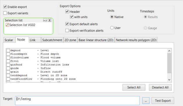

This manifest page is used to configure the automatic export of result to CSV files in the ICMLive Operator Client and to test the export settings in InfoWorks ICM.
Manifest - Result CSV Export page
Page description
Option Description
Enable export
If checked, enables the export of the baseline simulation results to CSV.
Export variants
If checked, the simulation results from variant runs are exported to CSV.
Selection list
A Selection List can be used to restrict the export of results to a selection of network objects. If a Selection List is not included, the results of all network objects will be exported.
Export Options
The following export options are available:
  • Header - If checked, a header row including network object IDs are exported to the CSV file.
  • with Units - If checked, units information is included in a second header row.
  • Export default alerts - If checked, alert instances generated by a run along with the results are exported.
  • Export verification alerts - If checked, alert instances generated by the verification of a run are exported
  • Units - Determines the type of units (current User units or InfoWorks ICM Native (metric) units) to be used when exporting results.
  • Timesteps - Determines the type of timestep results Results (timestep for summary results for all parts of the drainage system) or Gauge - (timestep for the detailed results for selected links in the system) to be exported.
Network Object Type and Attribute List
Network object type and attribute availability depends on the simulation selected in the Setup page.
Contains tabs for each type of network object for which results can be exported. Each tab contains a list of results attributes for the object type.
If checked, the attribute is exported.
Select All Checks all attributes on the current object type tab.
Deselect All Unchecks all attributes on the current object type tab.
Target
The path of the directory to which the results are to be exported. This can be typed-in or browsed for using .
Test Export
Enabled when a Target is specified.
Export the results of the currently selected baseline simulation to the Target folder.
Note: The test export functionality only applies to the baseline simulation selected in the Setup page, not to variant runs, even if the export of variant run results has been enabled.
This lets you check that the CSV files are the ones users want to get automatically exported on a deployed system (i.e. when using ICMLive Operator Client).
A log file is automatically generated in the target path. The information displayed in this file is useful for diagnostic purposes in case of export failure.
Tip: The location of export files is slightly different for automatic exports (performed from the ICMLive Operator Client). In that case, CSV files are placed in a sub-folder (with the same name as the run) that is automatically created within the selected target folder.
