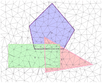

If Exclude roughness zone boundary when creating 2D mesh is checked, the zone boundary will not act as a break line when the mesh is generated. If the centroid of a mesh triangle falls within an intersection of any zone polygons, it will be assigned the roughness value of the zone with the lowest priority value. The example below shows how the roughness zones are attributed.
If Exclude roughness zone boundary when creating 2D mesh is unchecked, the zone boundary acts as a break line and mesh triangles will be generated up to the boundary. This may result in some very small mesh triangles around the boundary.

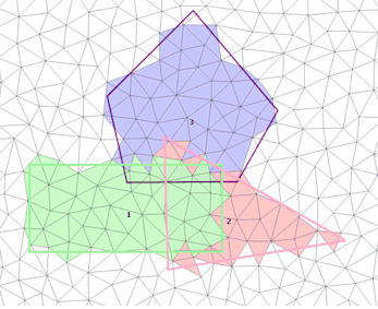

If a mesh triangle falls within an intersection of any zone polygons, the mesh triangle will be assigned the roughness value of the zone with the lowest priority value. The example below shows how the roughness zones are attributed.
