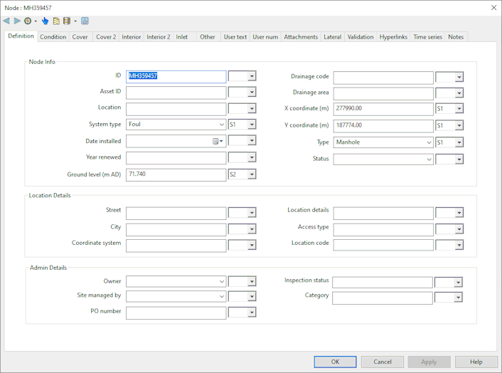

Tabbed Property Sheets
Applicable for asset network objects only.
To display tabbed property sheets for asset network objects, ensure that the Use property editor for asset network objects option is unchecked on the General Page of the Options dialog.
The data is divided up into pages or tabs showing data of similar type. Some data is common to more than one type of object, so a page may occur on more than one type of Property Sheet.
Tabbet Property Sheet
Most tabbed property sheets are modal. Work cannot be carried out elsewhere in the InfoWorks ICM interface until the property sheet is closed. Some property sheets do allow users to move to other parts of the interface and carry out other work. The property sheet remains visible but the title bar turns grey to show it is inactive.

Navigating between pages
To move between pages, click on the appropriate tab at the top of the sheet. Changes are not saved when moving from one page to another.
