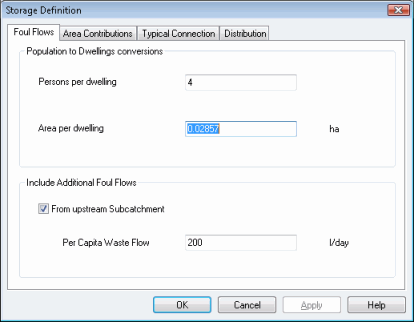

The foul only connections are converted into an equivalent connected area by assuming a housing density of 35 dwellings per hectare (or 0.02857 hectares per dwelling.) A connection length can then be calculated as before:

The number of persons per dwelling, flow per person and housing density can be changed on the Foul Flows Page.
Figure 2: Storage Compensation Dialog - Foul Flows Page

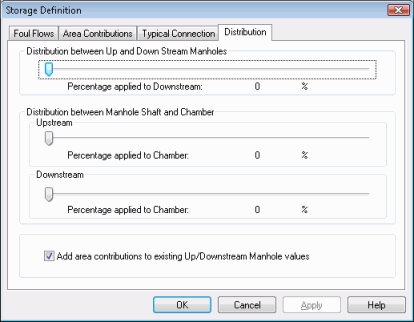

You then decide how this 46.25 m3 of storage is distributed between the up or downstream manholes and between the shafts and chambers of these manholes using the Distribution Page. By default, all the volume is applied to the upstream shaft area.
Figure 4: Storage Compensation Dialog - Distribution Page
