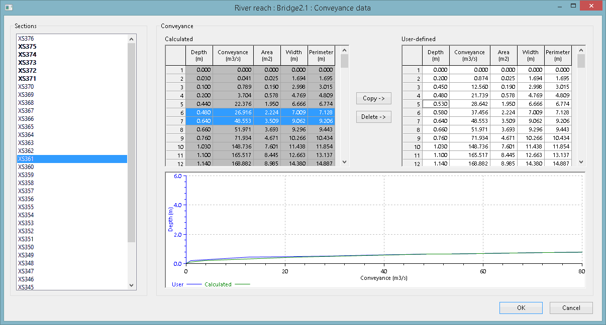

Sections
A list of cross-sections which comprise the river reach are displayed in this pane. Any sections that have user-defined conveyance values are highlighted in bold.
Click on a section in the list and its conveyance data is displayed in the Calculated and, if specified, the User-defined tables, and plotted on the graph.
Conveyance
There are two tables; the Calculated table, which contains the read-only conveyance values calculated by InfoWorks ICM for the selected river reach section, and the User-defined table. The fields which comprise these tables are described in the River Reach Data Fields topic.
Any user-defined values which have been previously defined are displayed in the User-defined table when a river reach section is selected in the Sections list. The values in the Calculated table cannot be edited but it is possible to add or modify the values in the User-defined table.

Graph
The conveyance graph shows the calculated, and if specified, the user-defined conveyance values plotted against depth. Right click on the graph to display a context menu that includes the following options:
Adding user-defined conveyance data
To add user-defined conveyance data by copying calculated values:
  1. Click on the Copy -> button to copy the all values in theCalculated table to the User-defined table.
  2. Edit the values in the user-defined table as required. Ensure that:
    • all rows contain both a Depth (m) and a Conveyance (m3/s) value.
    • the values for an Area (m2), Width (m) or Perimeter (m) in a row is not lower than the value in the previous row. A value may be unchanged in comparison to the previous one but it cannot decrease.
    • if the table contains any rows with an Area (m2), Width (m) or Perimeter (m) defined, then all rows must contain an entry for the Area (m2), Width (m) or Perimeter (m). However, the value can be 0.
  3. Click OK to save the user-defined conveyance data.
Alternatively, you can type the values directly into the User-defined table. Note that the same 'rules' apply as when editing the copied values as described previously in Step 2.
