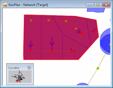

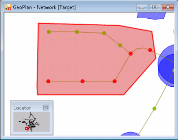

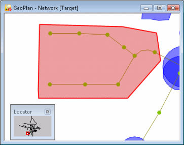

Subcatchment boundaries can be generated and updated using the Thiessen Polygon method.
A bounding polygon is required within which subcatchment boundaries will be generated. Boundary creation can be limited by making a selection of nodes within the polygon. Existing subcatchment boundaries can be optionally replaced.
To create boundaries using Thiessen polygons
Create within selected polygon from the Model menu. This option is only available if the polygon is selected. This displays the
Create Thiessen Subcatchments Dialog.
