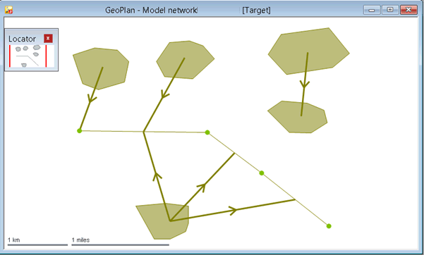

The subcatchment drainage is displayed in the GeoPlan as large arrows.
However, no arrows will be displayed when a subcatchment invalidly drains to more than one inflow node, link, subcatchment or 2D point source.

Subcatchment drainage in SWMM networks is displayed in the GeoPlan as large arrows. However, no arrows will be displayed when a subcatchment invalidly drains to more than one inflow node or subcatchment.

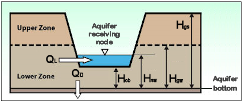

A subcatchment can be associated with an aquifer and a node in the drainage system that exchanges groundwater with the aquifer. By setting the coefficients that determine the rate of lateral groundwater flow between the aquifer and the node, ICM can calculate groundwater flow as a function of groundwater and surface water levels using the following EPA SWMM standard lateral groundwater flow equation:
where: QL is the lateral groundwater flow A1 is the groundwater coefficient Hgw is the height of saturated zone above bottom of aquifer Hcb is the height of surface water at receiving node above aquifer bottom B1 is the groundwater exponent A2 is the surface water flow coefficient B2 is the surface water flow exponent Hsw is the height of surface water at the aquifer node above aquifer bottom A3 is the surface groundwater coefficient |
The groundwater flow equation height inputs, in relation to the bottom of the aquifer, are illustrated in the following figure:
The rate of percolation to deep groundwater is calculated by ICM using the following EPA SWMM standard deep groundwater flow equation:
where: QD is the deep groundwater flow LGDR is the aquifier's lower ground loss rate Hgw is the height of saturated zone above bottom of aquifer Hgs is the height of surface water at receiving node above aquifer bottom |
These standard equations can be customised using the Groundwater Flow Equation Editor which is accessed from the subcatchment's properties.
