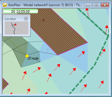

2D Nodes are used in 2D simulations to model the exchange of flood water between the collection system and a 2D meshed area. During a 2D simulation, flooding from the collection system to the mesh is modelled at 2D node locations.
A node is defined as a 2D node in an InfoWorks network if it is a node of type:

The 2D manhole node is used to model exchange of water between a manhole and a 2D meshed area. Surcharging of a 2D manhole results in an inflow to the 2D mesh element in which it resides. Similarly, water from the 2D mesh can make its way to the 1D network once it passes over a 2D junction node.
To define a 2D manhole in an InfoWorks network, set the Type field of the node to Manhole and the Flood type field to either 2D, Gully 2D or Inlet 2D.
