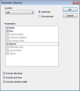

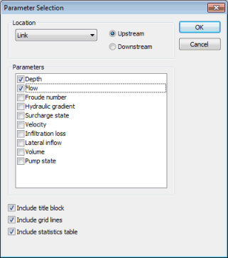

  3. Click Produce Graphs. This displays the Parameter Selection dialog.
  4. In the Parameter Selection dialog, select the type of location to view and the parameters to be graphed (up to three parameters may be selected at a time). For multiple locations, when plotting Link results, select whether to display results from the Upstream or Downstream end. Select other items to be included on the graph view from the bottom of the dialog e.g. title block, grid lines etc.
  5. Click OK to view the graphs.
  4. In the Parameter Selection dialog, select the type of location to view and the parameters to be graphed (up to three parameters may be selected at a time). For multiple simulations, when plotting Link results, select whether to display results from the Upstream or Downstream end. Select other items to be included on the graph view from the bottom of the dialog e.g. title block, grid lines etc.
    Tip: If only one simulation is specified in the Sim/SWMM sim box of the Simulations dialog, additional data - rainfall, ground level and flood level for nodes and rainfall and soffit level for links - can be graphed and specified on the Parameter Selection dialog.
