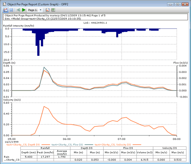

An example of the simplest graph type:
An example of a more complex report:

InfoWorks ICM displays a table at the bottom of the page giving statistics, including minimum and maximum values.
To show or hide the statistics table, right click anywhere in the graph view and choose Include statistics table or Exclude statistics table from the popup menu.

Multi page reports
Some more complex graph reports may contain more than one page. If the report contains more than one page, as seen in the example of a more complex report above, then you can scroll through the pages using the pgup and pgdn keys.

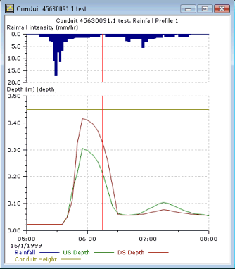

Moving to a different simulation time directly on the graph
On graphs produced by the Pick Graph tool or the Graph Selected Object tool only, the red time line shows the current time of the simulation, mirroring the current time of the simulation on the Geoplan. To jump to a different simulation time, you can drag and drop the red line to the desired simulation time directly on the graph. The simulation date & time will be updated accordingly on the Geoplan.
Right-click on the graph view and select Auto-label traces from the context menu to display a label showing the value of the trace at the current time of the simulation.
Run origin line
On graphs produced by the Pick Graph tool or the Graph Selected Object tool only, the blue time line shows the run origin time of the simulation.
