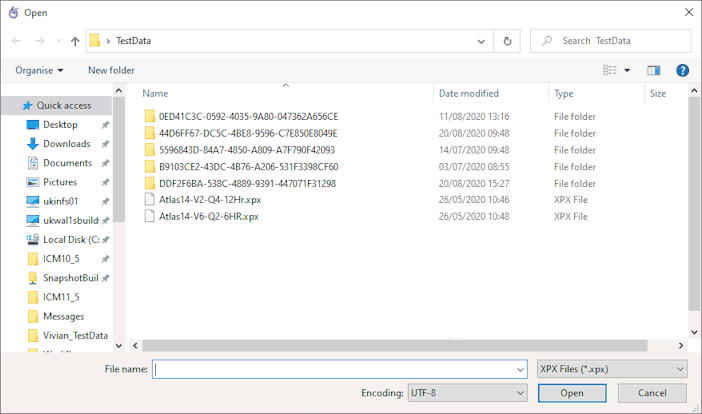

Data from XPRAFTS network models can be imported to an InfoWorks network in InfoWorks ICM using files in the XPX format.
To import XPRAFTS network data
Model
from XPRAFTS XPX file from the Network menu, and a standard Windows Open dialog is displayed.
In this dialog, choose which import options you want to use, and then click OK. For information about the import options, see the XPRAFTS Import Dialog topic.
An import report will be displayed with any import errors or warnings.
For details of the objects imported and any conversions made by the XPRAFTS Importer, see the Import Notes below.
