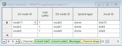

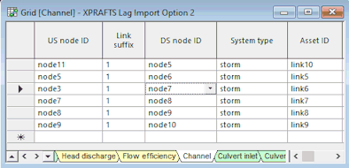

This section is only displayed if the network being imported contains lags links. ICM does not have an equivalent to an XPRAFTS lag type of link, however, lag link data can still be imported either as part of an ICM subcatchment or converted to a channel type of link in ICM. You can choose how the lag links, which are located downstream of XPRAFTS routing links, are to be handled on import by selecting one of the following options:

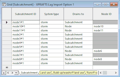

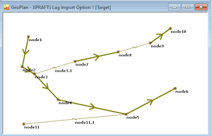

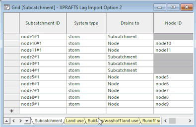

The selected import option also influences subcatchment drainage set by the Drains to property. If a node is connected by a lag link, the first subcatchment of the upstream node of a lag link will drain to the first subcatchment of its downstream node. If a node is not connected by a lag link, it will drain to a node. An illustration of how a network is imported using each of the import methods is shown in the example below. Example Example of XPRAFTS network to be imported:
In this network, links 1, 2, 3, 4, 5, 7 and 9 (shown in black) are XPRAFTS lag links. Links 6, 8 and 10 (shown in blue) are XPRAFTS routing links. Lag links 1, 2, 3 and 4 are upstream of routing links 6, 8 and 9, while lag links 5, 7 and 9 are downstream of the routing links.
