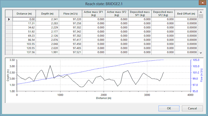

In the River Reaches grid click on the
button in the State column to display the State editor. Use the State editor to specify Distance from upstream node, initial Depth and Initial Flow values along the river reach.
For water quality simulations, active mass and deposited mass of sediment values may also be specified. The masses represent the total mass of sediment between the specified distance and the next entry in the table. Bed offset values are used for reaches that use the uniform bed updating method. (Bed offset will always be set to zero for reaches that use the invert bed updating method.)
Values can be ordered by right clicking on the Distance column and selecting Sort Ascending from the context menu.
