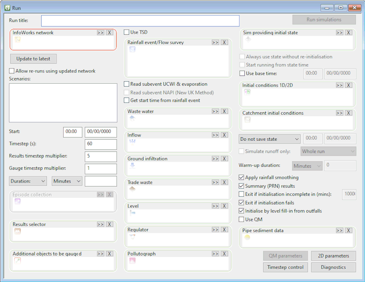

The Run view is displayed:
An example is shown below:
To run simulations, click:
Note: The name of the button is context sensitive, and therefore may change to reflect any modifications made in this window.
The total number of hydraulic simulations performed in a run is dependent on which items are specified in the Run view. The maximum number of hydraulic simulations generated will be:
Number of Time varying events (Rainfall events/Flow surveys or TSD objects) x number of Scenarios x the number of episodes included in an Episode collection
The number of runoff only simulations performed depends on which option is chosen to Simulate runoff only, as well as the number of time varying events and scenarios and whether or not an episode collection is included in the run. The option chosen to Simulate runoff only may also affect the number hydraulic simulations that are performed. See the description of Simulate runoff only for further information.
The items included in the Run view are described in the following sections and information about how to create a new run or re-run an existing one is contained in the Runs topic.
Dialog description
Run title and button
Item Description
Run title
The name of the run.
If the entered title already exists, exclamation marks (!) will be appended to the run name until a unique name is created.
If a title is not entered, a unique title of the form r0000012 will be generated for you.
Run simulations
Run changed simulations
Re-run simulations
Enabled when current settings in the Run view are valid.
Starts the run simulations process.

Initial conditions 1D/2D
To set initial values for level and inflow at nodes, and depth and flow at river reaches, drag an Initial Conditions 1D object containing the values into the Initial conditions box.
To set initial values for level, depth and velocity within each 2D Zone, drag an Initial Conditions 2D object containing the values into the Initial conditions box.
Only one of each type of initial conditions object may be included.
Values defined in the initial conditions objects will override values from a simulation selected in the initialisation Sim providing initial state box.
Catchment initial conditions

State saving
Item Description
State saving
Select an option for saving network state to be used as the initial state for subsequent runs:
  • Do not save state - do not save state information.
  • Save state at end - preserve the state of the network at the end of the last hydraulic simulation or the last runoff only simulation (if there are no hydraulic simulations) for use in a subsequent run.
  • Save state at: (time-date) - preserve the state of the network at the time-date specified for use in a subsequent run. This option can not be used when using relative times.
    Note that the state of the network will be saved at the first run timestep at or before the time specified. (A warning message will be output to the results log if the save state time does not coincide with the run timestep.)
Additional parameters
Item Description
This option is disabled when no time varying input (rainfall/flow survey event or scalar/spatial TSD object) has been specified.
A check box which determines whether of not runoff only simulations are to be performed. Unchecked by default.
If checked, the dropdown is enabled, allowing you to choose when runoff only simulations are to be performed:
  • Whole run (default):
    • If no Episode collection is specified, a single runoff only simulation will be performed for each time varying input and scenario included in the run, beginning at the start* time, and finishing at the specified end (Finish or Duration).
    • If an Episode collection is specified, runoff only simulations will be performed for each time varying input and scenario included in the run, from the start* time to the first episode in the collection, between each episode, and the periods between the end of one episode and the start of the next episode, until the specified end (Finish or Duration).
    No hydraulic simulations will be performed when Whole run is selected.
  • Warm-up:
    • If no Episode collection is specified and the Warm-up duration is non-zero, then for each time varying input and scenario included in the run, one runoff only simulation will be performed from the warm-up duration until the start* time. The state of each runoff simulation will be saved at the end of the Warm-up duration, and will be used to initiate the hydraulic simulation(s), which will begin at the start* time and finish at the specified end (Finish or Duration).
    • If an Episode collection has been specified and the Warm-up duration is non-zero, then for each time varying input and scenario included in the run, one runoff only simulation will be performed for the specified warm-up duration until the first episode in the collection. The state from the preceding 'warm-up' runoff simulation will be used to initialise the hydrology of the applicable hydraulic simulation. One hydraulic simulation will be performed for each time varying input and scenario included in the run.
  • Between episodes:
    • If no Episode collection has been specified, then this is treated the same as a Whole run, ie, single runoff only simulation will be performed for each time varying input and scenario included in the run, beginning at the start* time until the specified end (Finish or Duration). No hydraulic simulations will be performed.
    • If an Episode collection has been specified, then for each time varying input and scenario included in the run, a runoff only simulation will be performed from the start time* until the first episode, and then from each interval between the end of one episode and the start of the next episode, and finally from the end of the last episode to the specified end (Finish or Duration).
    • Hydraulic simulations will be generated for each episode in the collection.
      The state at the end of each 'between episode' runoff only simulation will be used to initialise the hydrology of the next 'episode' hydraulic simulation Similarly, the state at the end of the 'episode' hydraulic simulation will be used to initialise the hydrology of the next 'between episode' runoff simulation.
Note: *The start time for the runoff only simulations is either:
  • the specified Start time, or
  • the state time (if the Start running from state time box is checked), or
  • the earliest time in the rainfall event (if the Get start time from rainfall event box is checked and the Start running from state time box is unchecked).
Warm-up duration
Enabled when the Simulate runoff only field is set to Warm-up.
The period during which the states of a PDM model are warmed-up before any simulations are started. This allows the network to reach a steady state and thus provide more realistic hydraulic conditions when a simulation starts.
You can choose to define the Warm-up duration in various units from minutes to years from the adjacent dropdown, and specify the value of the duration in the adjacent field. This value must be an integer. The default is 0 minutes.
Apply rainfall smoothing
By default (box checked), ICM applies a simple moving average smoothing to rainfall to allow for spatial variation.
If the box is unchecked, rainfall smoothing will not be applied.
See Spatially Varying Rainfall for more information.
Summary (PRN) results
Check this box to produce a file containing maximum results and a summary of cumulative totals.
Exit if initialisation not completed in (mins)
Check this box to stop the simulation if the initialisation phase is not completed in the number of minutes specified.
The simulation will be stopped if the Elapsed initialisation time, as reported in the Job Progress Window, exceeds the time defined here.
Uncheck this option to allow the simulation to continue until initialisation fails or is completed.
Exit if initialisation fails
Check this box to stop the simulation if the initialisation phase fails.
Uncheck this option to allow the simulation to continue if initialisation fails.
Initialise by level fill-in from outfalls
Check this box to propagate outfall tide levels upstream, during the initialisation process, until an invert or control level is above the tide level. Use of this option may reduce initialisation times, particularly for models with tidal river reaches.
Note: Using this option may cause initialisation to fail in the case where beds have slopes of different signs between sections. Uncheck this option to carry out initialisation without propagation of tide levels.
Use QM
Check this box to model water quality as part of the simulation.
Pipe sediment data
Select a pipe sediment data object if you want to specify the initial sediment depths for pipes in the network.
Buttons
Item Description
QM parameters
Displays the QM Parameters dialog. Use the dialog to edit the pollutants and sediment fractions modelled or change the timestep for the water quality calculations.
Timestep control
Displays the Timestep Control Options dialog.
Use this dialog to allow the simulation to run at larger timesteps during periods of dry weather flow. This is useful for long time-series simulations, as they will run faster and require less storage space for results. You can also use timestep control to decide when to end a simulation after a storm.
See Dry Weather Flow Mode for more information.
2D parameters
Displays the 2D Parameters dialog. Use this dialog to edit tolerance and advanced 2D modelling parameters.
Diagnostics
Displays the Run Diagnostics dialog.
Here you can apply simple diagnostic limits to check the computational accuracy of the simulations.
