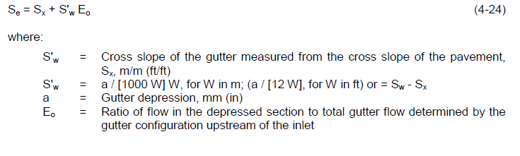

To model a depressed inlet, values for the following parameters are also required:
For drowned-forward or reverse flow, either drowned weir or orifice flow is used as for the Sag Curb-opening inlet with a nominal opening height of 100mm. The undepressed weir equation is used for weir flow.
Efficiency expressed as a ratio:
(6)
where:
L = curb opening length, m (ft)
LT = length of curb opening inlet required for total interception of gutter flow, m (ft)

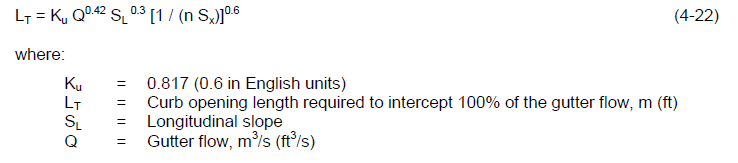

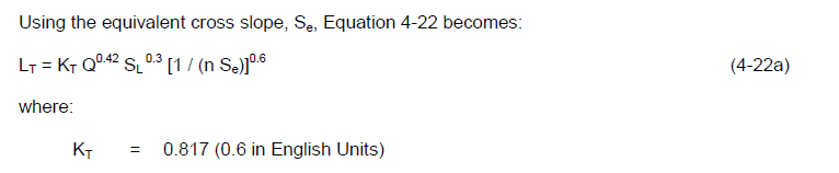

LT is calculated as:

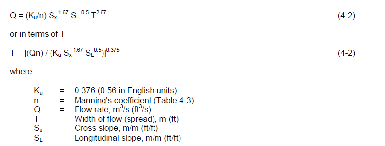

In the calculations for continuous curb openings, the simulation engine does not have access to the values of SL and n, but it does know the values of Q, T and Sx. By re-arranging 4-2 to get an expression in terms of SL and n, we can substitute this into 4-22a to determine LT.
