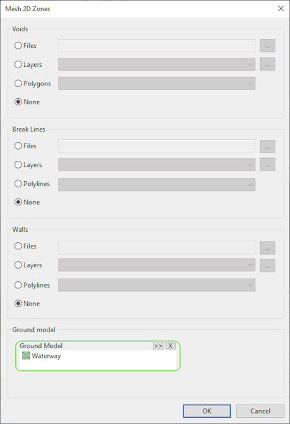

This dialog is used to
generate mesh elements for use in 2D modelling, and is displayed when Mesh 2D zones is selected from the Model
Meshing menu.
The dialog allows network objects or digitised GIS data representing voids, break lines and wall data to be read by:
button to identify the table.
button to display the
GIS Layer Control Dialog.
Specification of voids, break lines and walls data is optional. The default option for each is None.
A ground model must be specified for use in calculating heights of mesh element vertices. When the mesh elements are generated, heights of vertices will be interpolated from the selected ground model.
Click the
button to browse for a ground model file, or drag and drop a ground model item from the
Explorer Window into the Ground Model box.
