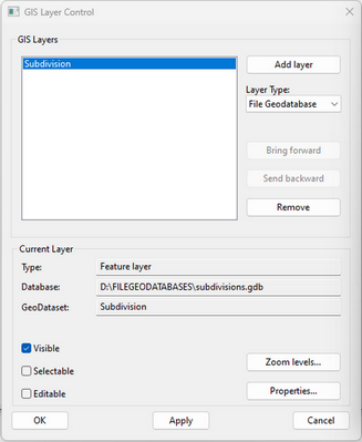

GIS Layer Control ArcEngine dialog
ArcGIS Engine GIS Layer Control dialog
GIS Layer Control ArcObjects dialog
ArcGIS Desktop GIS Layer Control dialog
ArcGIS Map (Tech Preview) GIS Layer Control Dialog
GIS Layer Control Map Xtreme dialog
MapXtreme GIS Layer Control dialog

All layers can be moved up or down, or forward or backwards, in the display order, added and removed, or temporarily hidden without removal. The layer can also be hidden automatically when the zoom level moves outside a certain range.
The GIS Layers box lists the layers that are currently loaded on the GeoPlan. The layers are added to the view in the order shown, with the layer at the top of the list being displayed above all other layers.
The following buttons change the layers that are displayed:
Up
Moves the selected layer higher up the list.
Down
Moves the selected layer lower down the list.
Bring forward Applies when using ArcGIS Maps as map control.
Moves the selected layer forward in the display order.
Send backwards Applies when using ArcGIS Maps as map control.
Moves the selected layer backwards in the display order.
Add WMS
Applies when using MapXtreme as map control.
Displays the Add WMS Layer dialog.
In the Add WMS Layer dialog, enter a WMS Server URL and click OK.
The WMS layer is added to the list of GIS layers.
Select the WMS layer and click the Properties button to view and edit the display properties for the layer in the Web Map Service Properties dialog.
Add layer Applies when using ArcGIS Maps as map control.
When Layer Type is set to:
  • Web Map
    Displays the Add Web Map Layer dialog so you can choose the applicable online map layer. Selecting a layer, then clicking OK, adds the web map layer name to the GIS Layers box.
  • Shapefile or Raster image
    Displays a Windows Open dialog so you can browse for the applicable file. Selecting a file, then clicking Open, adds itsname to the GIS Layers box.
  • File Geodatabase
    Displays the Add File Geodatabase Layer dialog so you can browse for the applicable feature layer. Selecting a Geodatabase folder, selecting a layer and clicking Add Feature Layer, adds the layer name to the GIS Layers box.
Layer Type Applies when using ArcGIS Maps as map control.
The type of layer that can be added. See Add layer (above) for details.
Add
Adds a new layer.
Remove
Removes a layer from the display (the data is unaffected).
You can change the following properties of the display for each layer:
Projection
Only available for shape files when MapXtreme is the current map control.
Click Ellipsis button to change the projection system for the currently selected layer. This displays the Choose Coordinate System dialog.
This option is not likely to be used very often but provides the user with a means of changing the projection system if the one originally associated with the layer has not been correctly interpreted by InfoWorks ICM.
Visible
If checked, the layer is visible.
Selectable
If checked, items in the layer can be selected.
(WMS layers and ArcGIS Server Map layers can not be made selectable).
Editable
If checked, the underlying data in the layer can be edited on the GIS Layer Information Dialog. See Viewing and Editing GIS Layer Data for more details.
(WMS layers and ArcGIS Server Map layers can not be made editable).
Note: ESRI ® Shape files (.shp) are not editable (Read-only Editable check box) when MapXtreme is the current map control.
Zoom Levels or Map Scales
Displays the Layer Visibility dialog, where you can specify the level range over which the GIS layer is to be applied.
Properties
Displays the Layer Properties dialog. This allows you to change symbol shape, size and colour for the current layer.
Note: The above does not apply to WMS layers, ArcGIS Server Map layers, or ArcGIS Maps (File Geodatabase) layers.
If the layer in the current row of the list is a WMS layer, clicking the Properties button displays the Web Map Service Properties dialog. This dialog provides detailed information about the Web Map Service and allows the visibility of layers to be edited.
If the currently selected layer is an ArcGIS Server Map layer, the Properties button will be disabled. Use your GIS software to view properties of ArcGIS Server Map layers.
