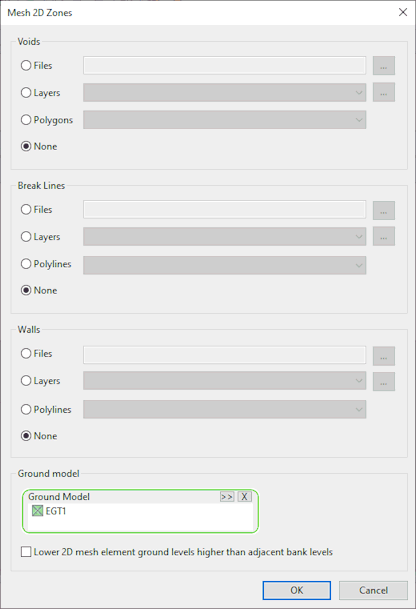

This dialog is used to
generate mesh elements for use in 2D modelling, and is displayed when Mesh 2D zones is selected from the Model
Meshing menu.
The dialog allows network objects or digitised GIS data representing voids, break lines and wall data to be read by:
button to identify the table.
button to display the
GIS Layer Control Dialog.
Specification of voids, break lines and walls data is optional. The default option for each is None.
Note that in addition to lines selected in the dialog as representing wall data, base linear structures (2D) and porous walls are always considered as representing wall data during the meshing process.
A ground model must be specified for use in calculating heights of mesh element vertices. When the mesh elements are generated, heights of vertices will be interpolated from the selected ground model.
Click the
button to browse for a ground model file, or drag and drop a ground model item from the
Explorer Window into the Ground Model box.
When the 2D mesh is generated, the heights at the vertices of the generated mesh elements are calculated by interpolation from a specified ground model. The ground level of the mesh element is calculated as the average of these heights.
Check the Lower 2D mesh element ground levels higher than adjacent bank levels option, automatically adjust the ground level of mesh elements adjoining a bank section that is lower than the element ground level calculated from the ground model. The ground level of the mesh element will be adjusted to match the bank level.
