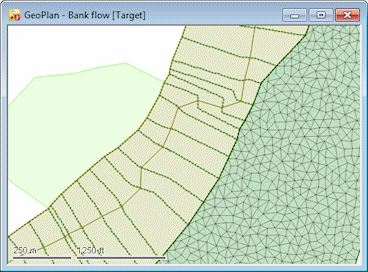

River reach connected to a 2D zone and storage area
