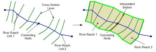

Multiple Reach Building
If multiple River Reaches are selected, the chosen build operation will be carried out on all selected River Reaches.
If the reaches are connected, an interpolated section will be inserted at the connecting node point to join the connecting reaches before the other build operations are attempted.
Exceptions to the joining of connected multiple reaches are as follows:
When building banks for multiple River Reaches, only two bank lines (assumed to be left and right bank) may be selected at a time. However, each bank object may extend over multiple reaches.
